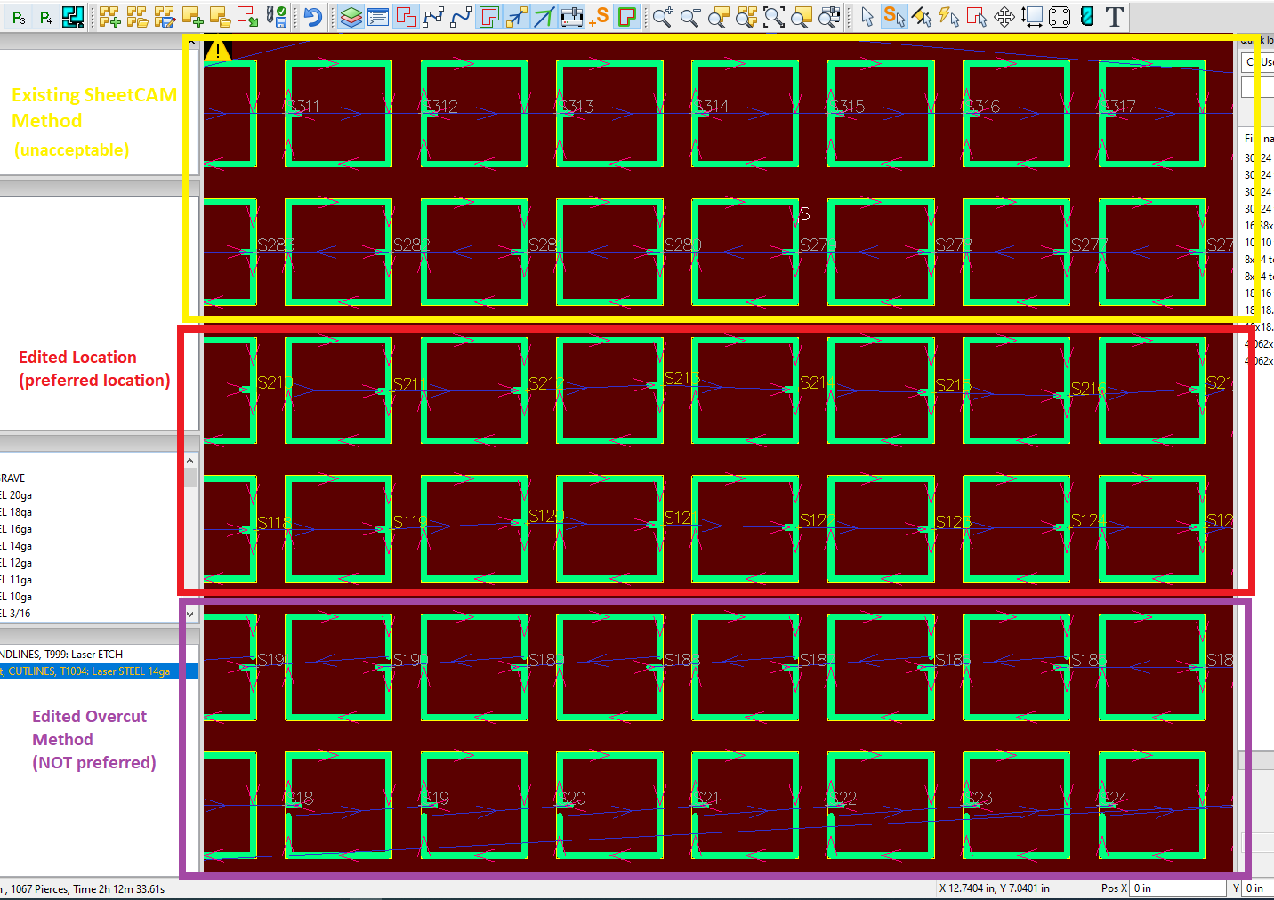

The start points are auto-placed on the closest side of the contour in the direction of rapid travel. This makes the programs extremely crash prone
Proper tipup avoidance is difficult to implement but I have changed the way start points are placed on the outline. Instead of being placed nearest the previous start point they are now nearest the next start point. For your application it will probably work well. As this changes the cut paths quite a bit I have uploaded a test version for you to try before putting it in a release. You can get it from here www.sheetcam.com/Download/SheetCamtest.exe. Note it will install as V7.1.35.

Proper tipup avoidance is difficult to implement but I have changed the way start points are placed on the outline. Instead of being placed nearest the previous start point they are now nearest the next start point. For your application it will probably work well. As this changes the cut paths quite a bit I have uploaded a test version for you to try before putting it in a release. You can get it from here > www.sheetcam.com/Download/SheetCamtest.exe> . Note it will install as V7.1.35.

Les, YOU ARE THE MAN!! That is exactly what I was talking about!!! You mean to tell me I have been begging for this for years and it was that easy for you to fix? lol. For real though, that seems to work perfectly right now. I’ll try it out for a week or so and see if I find any issues with it, but right now it looks perfect!

The reason why I have been holding off is that proper tip-up avoidance is hard. What I did is a hack that only works in some situations. It just happens to work well for your specific application.
