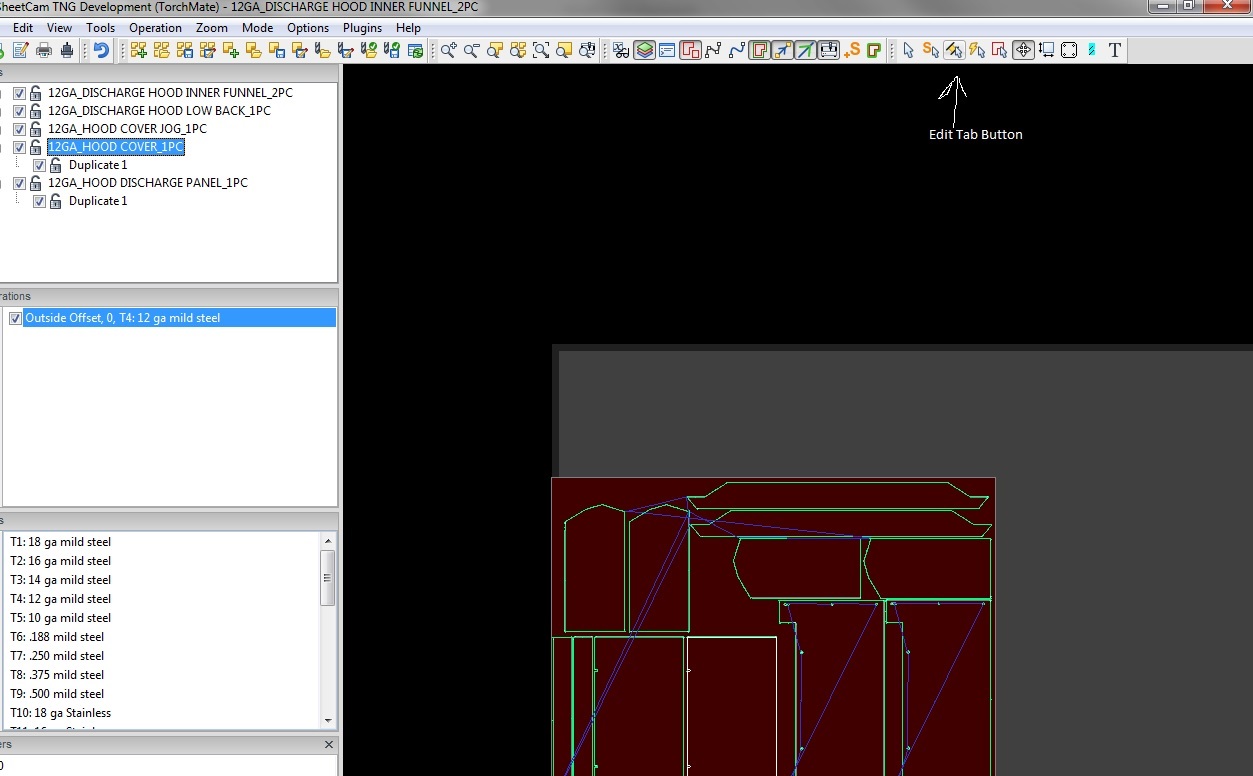

Anybody know how to use the auto tabs in sheetcam ? I have seen the screen and all the settings but cant make it work ?? :open_mouth:

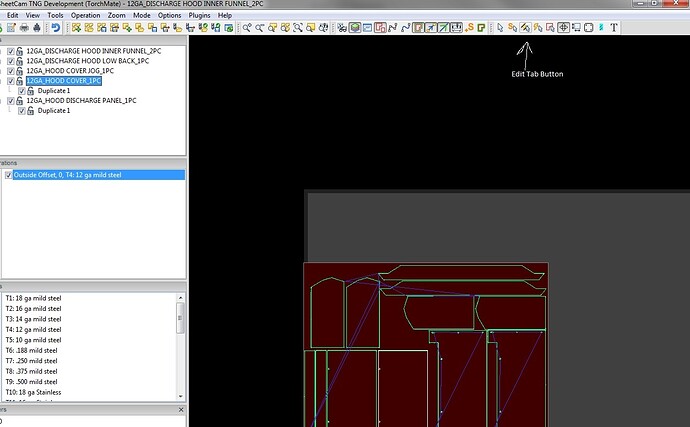

Along the top of the screen, you’ll find the ā€œEdit Tab Buttonā€. That will allow you to place and or move your tabs
Make sure you have the correct operation selected then switch to tabs mode (see OldHippie’s screen shot). Right-click and select Options.
These are the auto tabbing options:
Minimum number of tabs - on smaller shapes it will not place less than this number of tabs
Max tab spacing - on larger shapes tabs will be no further than this distance apart.
Tabs on inside cuts - if this is enabled tabs will be placed on both inside and outside cuts. If not, tabs will only be placed on outside cuts.
Click the ā€˜Place tabs’ button to make it place the tabs.
