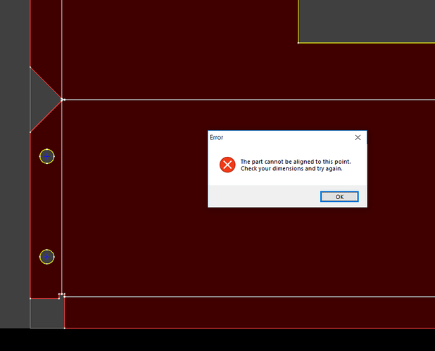

Hey Les, not sure if this is a bug or not but it has happened on several different drawings for me now. I frequently cut door pannels what have a square cutout in the corner and the easiest way i see is to just use the align tool twice on two different points to get the corner on zero. Everything works perfectly for the first point, but when i click the second point and type the zero coordinate, i get the error in the attached picture. I have found it does not matter what the actual coordinate i type in is, it happens anytime i use the align mode twice in a row. If i switch to nesting mode and move the part even one click in any direction between using the align mode, it works perfectly fine.
The align function expects up to two points. The first sets the X,Y coordinate. The second is optional. If you use it you need to select another point on the same part. This allows SheetCam to work out the part rotation.

My process is 1) click align mode button. 2) Select point on part. 3) popup with x,y location pops up. I leave x coordinate as is, change y to 0. 4) press ok. 5) click another point on same part. 6) leave y coordinate as is, and type 0 for x. 7) press ok. error pops up.

You can enter an angle directly in the angle box at the bottom of the main window. You can also use the X and Y position to move the part.
I see what you are saying now, that would be very useful in that sense. And thanks for the info, i never realized those were editable boxes before. I never even tried to type anything there lol. You have all kinds of stuff already built into the software, thats awesome!
