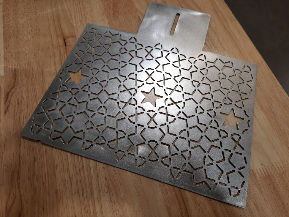

I’m cutting this piece on a Crossfire Pro with a 0.8mm tip, 22ga steel. It has 333 pierces and has serious warping.
Here’s my question, I want a 10 second cooldown pause before or after each cut. I’ve tried all the rules (on start, before end, lead in and out, etc) and can’t get sheetcam to insert my code snippet when the torch is off. Can I do this with rules or will I have to modify my post code?
Craig

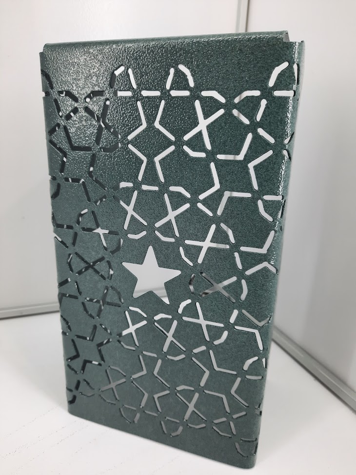

ps. its a porch light shade

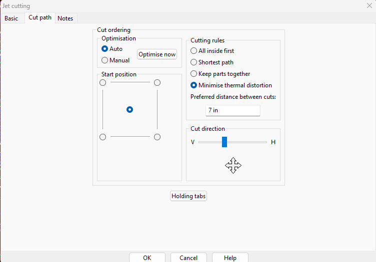

In your cut operation go to the ‘cut path’ tab and enable ‘minimise thermal distortion’ and set the distance to something like half the width of your part.
If that doesn’t fix it I can modify the post for you.
I have that enabled already.

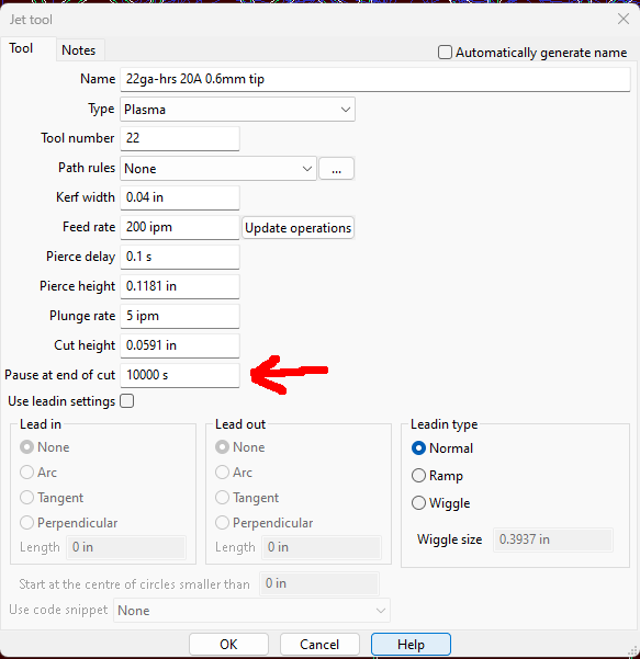

I looked at the Crossfire Firecontrol post and there’s a provision for adding this delay in onPenUp()
function OnPenUp()
   ihs = pierceHeight ~= 0 and cutHeight ~= 0 --enable IHS if both pierce and cut are non-zero
   post.Text ("H0\n") -- thc OFF, Machine in control of Z
   post.Text ("M5\n")
   if (endDelay > 0) then
      post.Text ("G4 P")
      post.Number (endDelay,"0.###")
      post.Eol()
   if (ihs) then
      post.TextDirect ("G0 Z" .. post.FormatNumber(25.4 * scale, "0.0##") .. "\n") -- Z to rapid height
   post.CancelModalNumbers()
However setting a post variable endDelay didn’t work right. Then I found this, Thanks for your help. I hope that others find this useful as well.
Which does exactly what I want.

NOTE: “Pause at end of cut” should be seconds, 10, not 10000.
