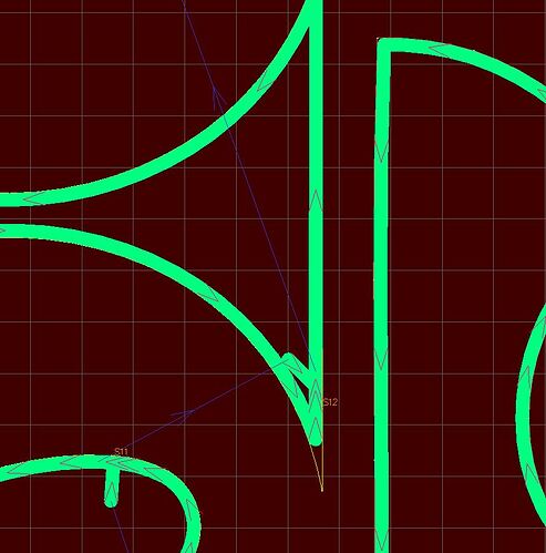

Once imported into Sheetcam, though, I run into issues. Sheetcam seems to want to place lead-ins in corners as often as possible, or other “tight” areas, where my pierce divot will create a blemish. As such, I have to go in and place/move the lead-ins manually, which is quite time consuming. If Sheetcam would place the pierce points away from areas it can blemish (by default), it would essentially remove the lack of in-program part nesting.
Would it be possible to have a check box which tells Sheetcam to start the auto-generated leadins “in corners”, or “in open areas” )with open areas, ideally, being as far away from other cuts as possible)?

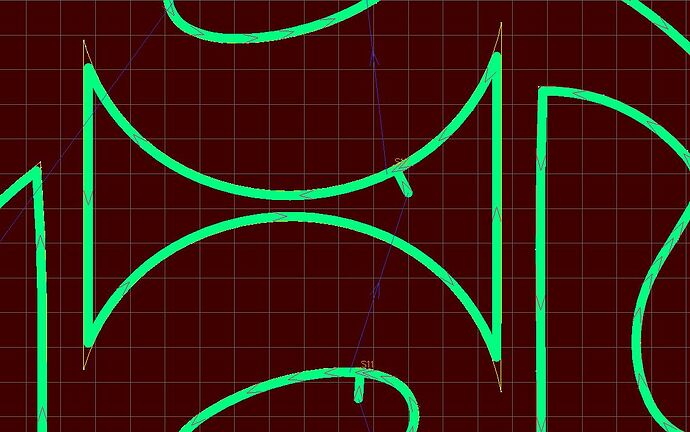

I’ve attached a couple of photos to aid in the description. The first shows where Scam placed the pierce/lead-in, when applying the toolpath. As you can see, this is deep in a corner, and the pierce is likely to blemish the edge (near the pierce) where it’s close to the wall. The 2nd photo shows how I move the leads to “open” areas, so I don’t have to worry about this.
If Scam could be told to “place the pierce/lead-in away from other edges, if possible”, that would be a tremendous help.

It’s in the next dev release, due out today. Start point handling has changed quite a bit in this release. When you load a drawing, SheetCam will move the start points around to try to reduce the rapid distance between cuts. The start points will prefer convex corners but depending on the shape, may fall back to convex arcs or as a last resort the middle of a line.
If you change operation settings, SheetCam may move start points to get the best cut paths. For example what is good for an outside offset may be bad for an inside offset. If you manually move a start point it will be locked in place and will no longer be automatically optimized. You can also lock/unlock start points from the right-click menu in start point mode. When you load a job created by an older version the start points will default to locked. This is so that old jobs cut the same as when they were originally set up. You can of course manually unlock the start points to allow SheetCam to do it’s thing.
