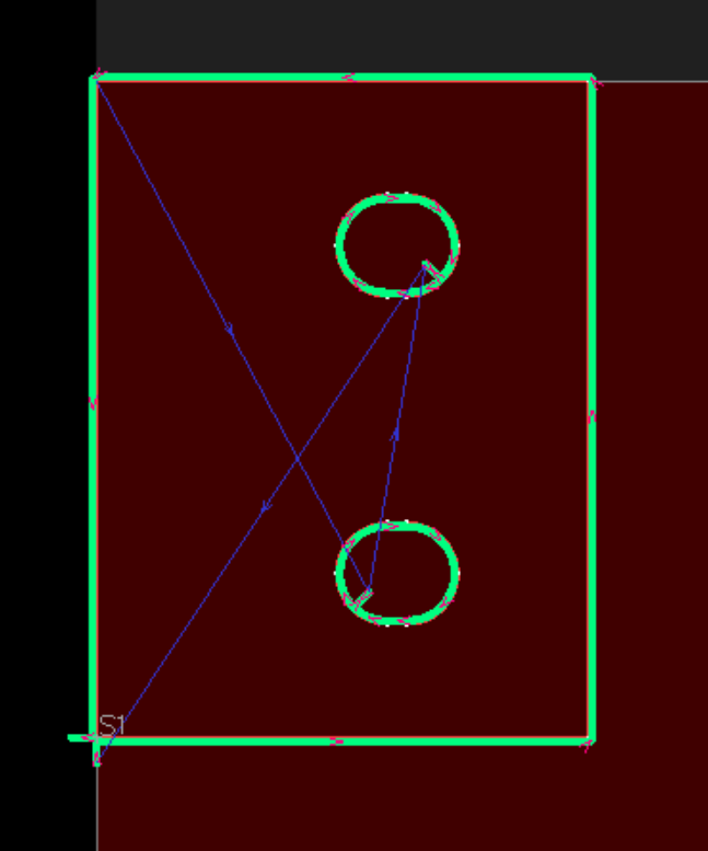

Hi all,
I am trying to cut out a very simple 2D profile on a router table, but I keep getting the error "open paths not offset" I thought I corrected this based on the information I found on this forum. Unfortunately, not. The file is actually a closed path. I have redrawn it twice in Solidworks to confirm this, and exported it about 20 times as a DXF. No fix. I have zoomed in as far as possible and the path is still connected.
Additionally, the 3d part is rendered in SW so it must be connected.
What can I do to correct the issue? What am I missing? Obviously I am missing something.
Running the latest stable SC version.
Thank you,
Going Crazy

Upon doing more research this may not be an issue with SC. Looks like it is related to the way i have drawn the part using splines. Basically, I have drawn an arch using splines and connected the bottom with a short line on each end. For whatever reason the splines are causing my issue. Strange.
Re: Going nuts over "Open paths" that are not actually open...
Yes, SheetCam doesn't work well with splines. If you can convert the splines to polylines you will have better luck.
As a side note, if you turn on path ends in SheetCam you can check your path for little white dots. It will help you find inadvertent open paths.

First of all, make sure View->Show segment ends is turned off. Make sure View->show path ends is turned on. You will now see white dots where SheetCam thinks there are gaps. Zoom in on the dots. Can you see any gaps? If not you could have part of the outline on a different layer.
Show the layers (View->layer tool). Do you have more than one layer? If so you can select each layer by clicking on it. That may give you an idea what is going on.
If you post a copy of your dxf here I'll take a look and see if I can figure out what is going on.

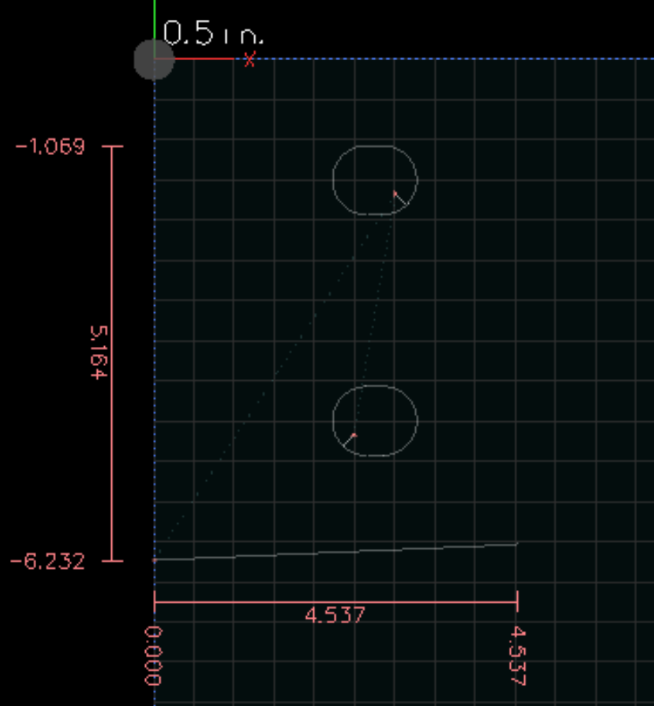

Thanks for the response guys. Sorry for the long wait. The holiday and the summer shutdown at work has me all tied up. Unfortunately, I had to redraw the entire thing line by line to get it to work. I do not know what the difference was but I will attach the DXF here. Maybe someone can tell me what my issue is.
Thanks All.

I imported your DXF into Coreldraw and the first thing I noticed is there were 3 objects.
There was a small vertical line inside, then the outside was actually one object laid directly on top of another object.
When I zoomed in I could see one of the outside objects was smooth, while the other one was made of straight line segments.
The first image "3 OBJECTS" shows the three individual objects listed to the right.
The 2nd image "DOUBLE LINES" shows a zoomed in view so you can see the smooth outline and the "segmented" outline.
The 3rd image "OBJECTS SEPARATED" shows the two outlines separated.
So for whatever reason it seems your software is spitting out this type of DXF.
Keith
Keith
