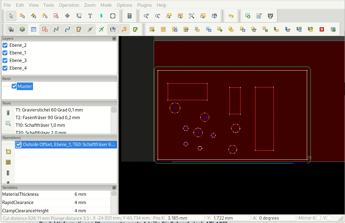

SheetCam comes with a lot of post processors. You can find which one you are using by hovering your mouse over the 'run post processor' button or by going to Options->machine->post processor.
Just a thought - go to Options->job options and take a look at the rapid clearance. What is this set to?
Re: Code Problem?
The post processor is mach3 and the rapid clearance set is 4mm ( this has always been the same
as i have never changed it. I am thinking that it must be a problem with mach 3 then?
Roy
Roy
