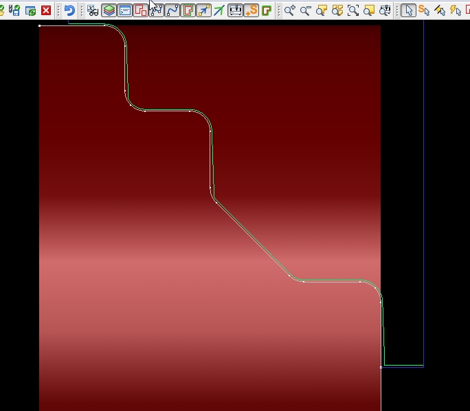

But, why does the path taper along the otherwise perpendicular faces ?
Doesn’t follow the contour very well.

The slope had me puzzled for a moment but it is caused by your tool definition. You have a side angle of 0 degrees with a clearance angle of 2 degrees. When generating tool paths SheetCam adds the clearance angle to the side angle to ensure that you don’t end up dragging the whole length of the cutting edge against the work. You probably want to increase the side angle to around 5 degrees as most insert tools have a built in angle of at least 5 degrees.

That works well now, thank you for the (as always) concise explanation !

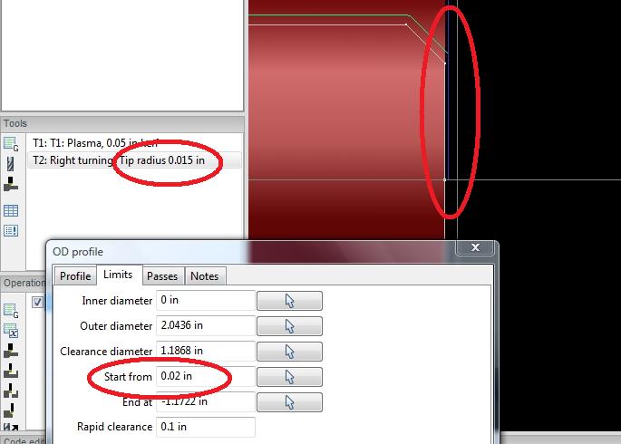

Another question for you :

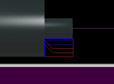

In the attached, a tool with a defined tip rad. of .015" will not attempt to cut the face of the stock unless the start point is entered as at least twice the
tip radius. Here I have .020" for cleanup but the tool refuses to go there.
If I make the start point Z +.032" it will work.
May be an easy fix ? On your end … or maybe mine.

It’s starting the path 1 tool radius in from the start point and ending 1 tool radius before the end point.
Looking at the code I specifically offset the start and end points but now I have no idea why I did it!

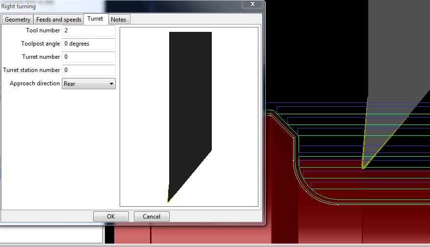

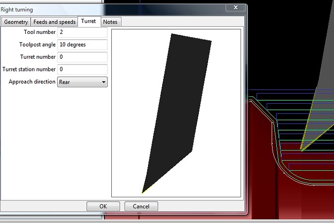

Changing the tool post angle in the Turret tab also has a strange effect on the toolpath.
It actually cuts closer to the profile than the (my) graphics show, but you can watch the Z DRO as it certainly does in fact cut a shallow taper to that face.
Changing the angle to a negative value shows a better toolpath but of course wrecks the shank and toolbit.
Looks like a +/- angle direction in the calcs might correct this ?

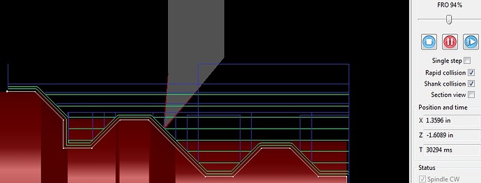

I’m getting ready to buy the lic and cut some actual parts. But can’t get past this collision detail.
Not sure how to get around it as I’ve configured the tool many ways to allow sufficient clearance … ( I think).
Looks like it might want to rapid to the clearance X through the relief angle of the bit … ? Not sure.

It looks like the taper from the tool post angle is caused by the path generator appying the tool path angle the wrong way around. Reversing the turrent angle generates the correct tool paths but simulation will get upset. I’ll have to fix this.

The rapid collision warning is a tricky one to fix. The tool paths are fine. If you zoom in on the collision area and simulate the cut at very low speed you can see it is fine. The problem is in the way simulation works. It works in discrete steps (roughly 30 steps/second). The amount the tool moves between steps increases as the feed rate increases. The bigger the steps the less accurate collision detection is. I need to do some work on this to make it less trigger happy.

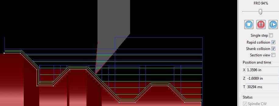

Hi Les. looks like maybe the initial perpendicular retract should be at feed rate, then rapid. Or, more like the way the rapid retraction is done in the M3 wizards …G00 angled away from the shoulder.
Thanks !

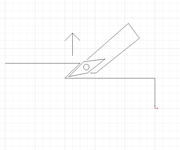

Attempting a G0 while the tool is currently “under” the material.
An exaggerated view …
Maybe G1 out the depth of the cut to clear the material, then G0.
