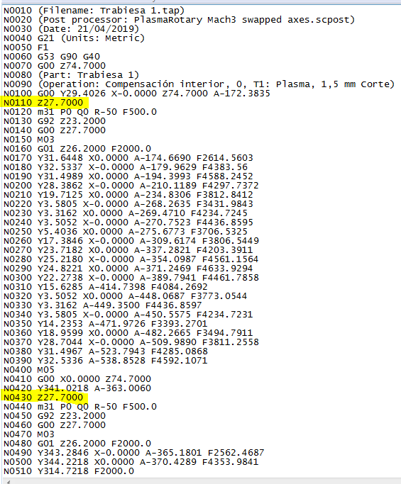

Now I have a little problem in the G code that the postprocessor generates, it’s a line that I get over when I’m going to look for the Z axis probe.
The postprocessor that I am using is PlasmaRotary Mach3 swapped axes.
Can you tell me how I can eliminate it from the postprocessor?
PlasmaRotary Mach3 swapped axes.scpost (8.24 KB)
The post assumes your Z is roughly correct when you start. Are you having trouble with just the first Z27.7 move or all of them?
I have problem in all the movement should look for the M31 at the height of Z 74,7 mm and not at the height of Z 27,7mm.
The diameter of the tube is 50.8mm
