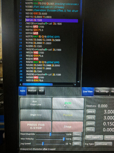

Are there any updates to this? The modified post for CommandCNC is not working.
If we could just go through and pierce the holes, clean the pierce slag off the plate, and then cut with new consumables life would be good!
What problems are you having with the post?
It makes it to line 12 with "unexpected Character after O-word. It does appear to go to the 1st location and stop.
I just checked and the format looks correct for LinuxCNC. Are you using LinuxCNC?
Yes I have CommandCNC from CandCNC.
I think I have found the problem. Try this version.
THC_pre-pierce_LinuxCNC.scpost (4.29 KB)
I just tried the new post and it didn’t work. It loads and when I push “run” in CommandCNC nothing happens. In the bottom left corner it says “Must use G0 or G1 with G53”
I edited the g code file by removing G53 and run the file again the machine worked as normal and it made the first pierce successfully but after making the second touch off the torch didn’t fire and it continued to the 3rd point and it pierce successfully. The machine continued by this sequence up to the end of g code file.
If you edit the post you can remove the G53. It is on line 51.
I can’t see any reason why it would only pierce every second cut start. It could be that the pierce delay is too short for your machine. Try increasing it. If you still can’t get it to work post a copy of the g-code file here so I can take a look at it.
