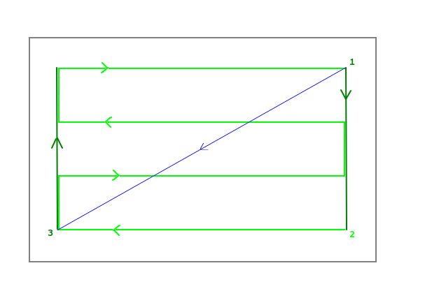

This example below would have the same time cutting air like zigzag pocket 2. But this avoid the forward and backward move.
Addionally you could add a checkbox “force same direction” where you have an even number of zig zags (like in this example) though it could be done with one pass less. But this only would make sense if you have a fixed step over. (height dived by passes in this example)
I hope you can follow me…
Unfortunately your suggestion only works for rectangles where the height is an exact multiple of the step over. Rectangles are the easiest possible shape for a zigzag pocket. Whatever I do has to be able to handle any shape you throw at it.
Thinking about it, if you try that exact shape with the current algorithm, you’ll find it spends less time cutting air and with fewer rapids. Rapids can be quite time consuming, especially if you are using a shallow ramp on the plunge.

Only if you take the step over value as a fixed value. Assume you have a rectangular pocket with a height of 35mm and a 10mm mill. So you need 3 passes with 10mm step over and one with 5. But you can divide it into equal steps of 8.33 mm. So you have the same thing.
Yes but zig zag pocket makes only sense on rectangles and similar primitive shapes. Because on more complex shapes a spiral pocket with 50% step over takes almost the same time as zig zag 2 with 90% step over. So I think the zig zag pocket can be optimised for rectangular pockets.

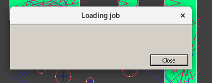

Unfortunately this didn’t really work on my machine :frowning:

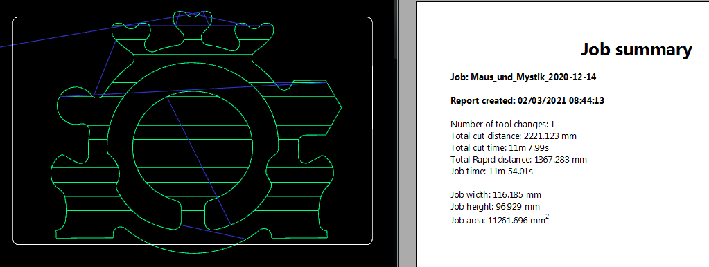

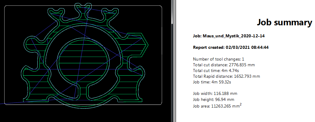

While comparing zig zag 2 with and without cleaning pass, I made some weird observations in time calculating.
I think the job time without cleaning pass can’t be twice the time with cleaning pass.
Yes, that does look wrong. Shorter cut and rapid distances but much longer cut time. That’s not right. I need to run some more tests.

I did some speed testing comparing the new zigzag and the zigzag 2 without cleaning pass.
On rectangular contours the speed is almost the same as one can imagine.
But the bigger profit is on complex contours where the backward moves takes more time.
Not to mention zigzag 2 with cleaning pass. That would need much more time to achieve the same surface quality like the new zigzag.
