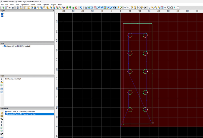

Hello, For holes with my settings, with inside offset i get 1/16 smaller hole than my drawing. Is there a way to reverse it to get bigger hole, like using outside offset ?? but when i set on outside offset the lead-in is on the wrong side.

what is your kerf set at within the tool you are using?
Inside offset, offsets the cut to the inside of the shape (hence any lead in will be on the inside) and the offset is 1/2 the kerf width (if your application is plasma) or 1/2 the tool width if your tool is a milling tool.
Ouside offsets, offsets the cut to the outside of the shape..... hence the leadin will be on the outside.
No offset puts the cut to the centre of your shape (circle).

One option is to tweak your kerf width in the tool definition. If you reduce the kerf width by 1/16 the hole will end up 1/16 bigger.

I already think to do that, but it will change all the cut. Maybe i should make a tool for outside offset and for inside offset ? is it the only way ?

I made another tool for hole, but when i cut several parts it make all the holes for all the parts, i prefer make one part at a time. Nothing is perfect in this world :cry:

You need to make 2 operations for each part. First one is the holes, second one is everything else. Then it will cut like you want.

Go to Options->job options->Nesting and change from 'minimise tool changes' to 'keep parts together' It will now cut the holes for the part then the outline before moving on to the next part.

You define one tool with the tweaked kerf width and another with the correct kerf. As far as SheetCam is concerned these are two independent tools, even though they are actually the same physical tool.
