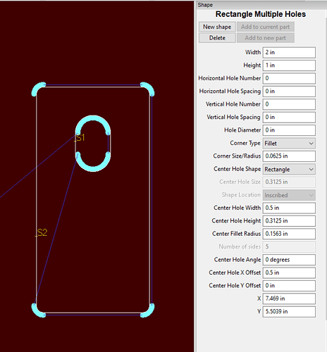

H guys, ive only been using sheetcam for a few months and this is the first issue that i have had with it. when i run the post processor, it tells me that everything is fine and that sheetcam has created the g-code for me. when i try to bring it up into my mach3, for some reason it has no code and i can see that there is no part. any help would be greatly appreciated. THANKS

thank you for the response, sheet cam is exporting in a tap format. i have tried opening in tap and all files into mach 3. im not getting anything
This is an example of the code it is giving me:
N0010 (Filename: attemptthreeuntitled.tap)
N0020 (Post processor: Mach3 plasma pauses.scpost)
N0030 (Date: 11/10/2016)
N0040 G20 (Units: Inches)
N0050 G53 G90 G91.1 G40
N0060 F1
N0070 S500
N0080 (Part: attemptthreeuntitled)
N0090 M05 M30

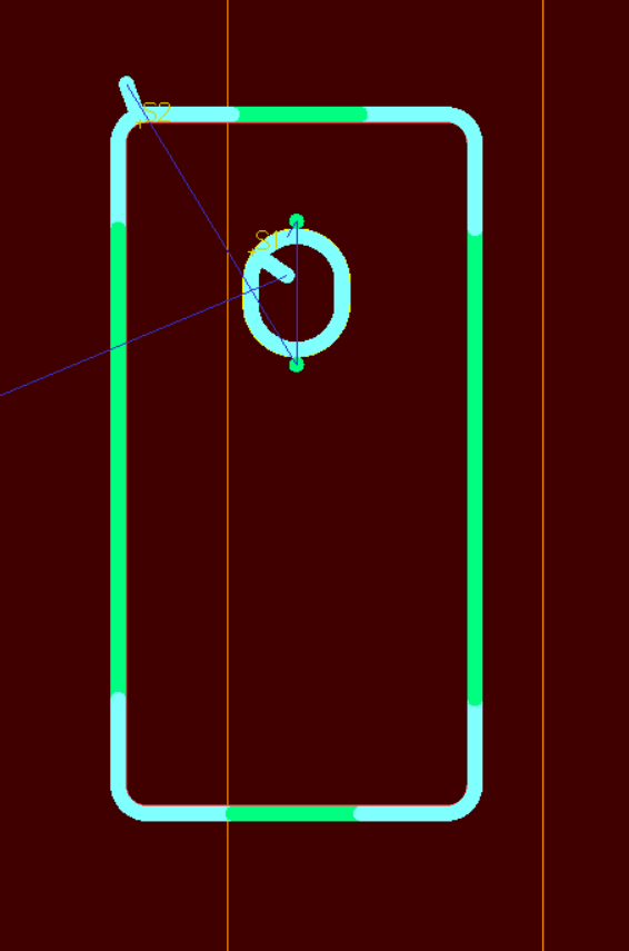

N0060 F1
N0070 S500
N0090 M05 M30
